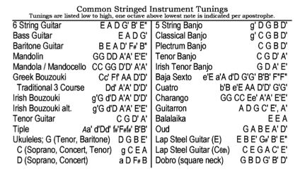

Lance, now you know why you should always have my card in your wallet.
If you don't have one or have never flipped it over, here's the back.
The one typo I know of is the baja sexto, for which I think I listed a tuning
more common with the bajo sexto. I haven't had too many people
complain about it though.

David, you left off the most important of all, the Lute.(8-course) Dd,Ff,Gg,Cc,ff,aa,d'd',g'! for 7-course, omit the Ff. Dear, dear.
PostPosted: Sun Jul 08, 2007 2:56 am
Plus your Irish bouzouki is an Octave bouzouki, and some of us would dispute the 6 string guitar tuning shown
And where's the cittern
PostPosted: Sun Jul 08, 2007 2:58 am
Dave, you'd need an Encyclopedia Brittanica, not a wallet card to fit all the Cittern tunings in!!!!
PostPosted: Sun Jul 08, 2007 3:38 am
Posts: 2060
The key is the first word - Common... This meaning if a player
does not specify otherwise, the most likely tuning(s) to consider as a
default. I may replace some of the Central American instruments with
more middle Middle Eastern and Mediterranean since moving to SE
Michigan. Amazing what a 70 mile relocation can do to your client base.
Still, as Sam said unless I give a magnifying glass with each card or work
in some fancy origami, the cittern would be a tough to squeeze in (unless
someone can give me one or two tunings that will fit most
cittern players ). The pages-long list I keep at my bench is a little
more complete.
For a what you can legibly fit on the back of a business card it makes
a handy pocket reference for many. It costs a bit more to get them
printed, but certainly makes a lot of people want to keep one in their
wallet.
PostPosted: Sun Jul 08, 2007 7:30 am
Posts: 2711
Location: Victoria, BC
Last Name: Abercrombie
David-
That's a cool idea.
Thanks for posting the back of your bus. card.
Is the 'pages long' version in a computer file that you could post somehow?
It would be a useful reference, though I doubt I'll come across many instruments that aren't in the 'short list' !
